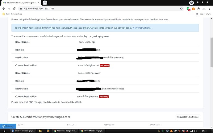

Hi…i have a new account here and a domain registered at One.com…
The thing is that i need a way to put my site under “https://”…
I have pointed the CNAME to One.com and asked for a Free SSL Certificate at my account … since Sunday (13, June) …this is what shows:
No, pointing to the “Destination”.
You have to create 2 CNAME records with “Record Name” pointing to “Destination”, not “Current Destination”. For example:
_acme-challenge → (the second blank in the picture).acme.infinityfree.net
_acme-challenge.www → (the last blank in the picture).acme.infinityfree.net
After doing this, both “Not Ready” should turn green and you can request SSL Certificate.

There’s been an issue with certificates so it might broke things up if you set your Cloudflare SSL mode to “Full” or “Full (strict)”, set it to “Flexible” for now until that issue is fixed. Check out the pinned posts on forum about this issue or : Read this before posting a new topic
You only added the “acme.infinityfree.net” part you have to add the entire destination, not only that part. The entire Destination URL is required, not only that part of those URLs.

There is a record shown in the Destination field. That’s the value you need to use.
Please don’t overthink it. Just copy the value from the client area in the control panel. We’re doing our best to make this as easy as possible. Coming up with your own DNS records is not easy. If you only needed acme.infinityfree.net or example.com.acme.infinityfree.net, we would have shown that value instead.
