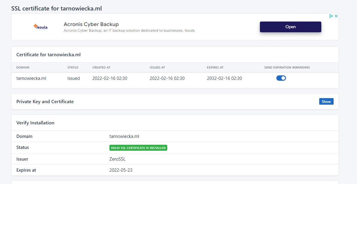

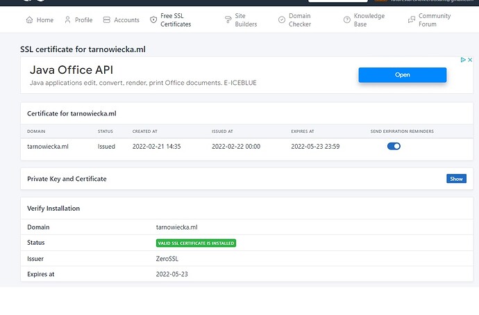

i’m sending screens of my ssl certificate panel and as you can see the previous certificate and the new one have a status of an installed certificate - is this a problem? I have no idea how to remove a certificate.
I think the op from the previous topic i posted in made their website in a similar manner to me and they have a lock icon now so their certificate works, while mine still shows ‘unsafe’ while the certificate is valid.

This sounds like a case of SSL cache. Chrome and derivatives are known to remember old SSL data for a while, and clearing your browser cache does not clear SSL cache.
This is why I always recommend to test in Private Browsing mode, because it bypasses this cache.
