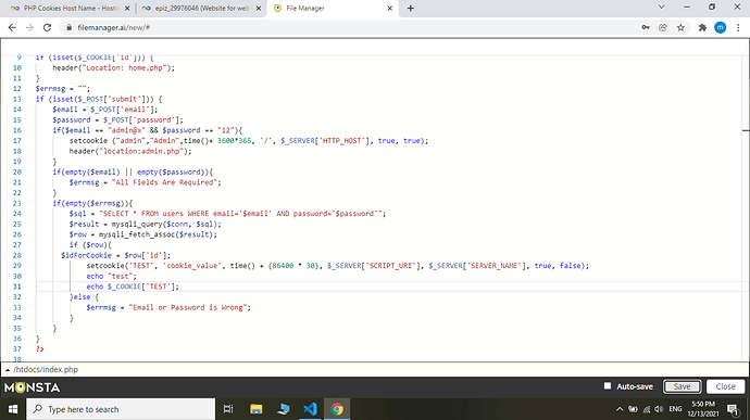

i tried it didnt work this is the code
setcookie(‘TEST’, ‘cookie_value’, time() + (86400 * 30), “/”, “.epziy.com”, true, true);
Try like this
<?PHP
setcookie('test', 'lang-en', time() + 96400, '/', 'web-tec.epizy.com');
print_r($_COOKIE)
use proper and complete syntax:
setcookie(name, value, expire, path, domain, secure, httponly );
